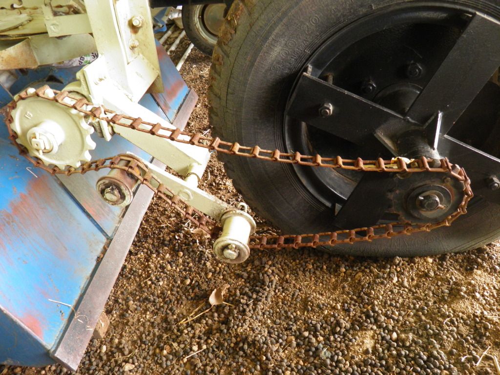

Actually Sarge it wasn't but steel a straight bar held into the wheel by bolts with a sproket mounted in the middle of the bar - quite simple really, same as a more modern Marshall Spreader.
I have just purchased an old three tonne Marshall for my weekender to throw a bit of super around so I will take a photo of that this weekend and post it so that you can see how it was mounted, althought this Marshall is slightly different, the concept is the same.

Here is the drive for a spreader
This one is a cross pattern, overkill really as they only ever needed a single bar.
Even later drives had the sprocket bolted straight on to the axle by using longer studs in the truck axle.
As the drive hung out from the edge of the truck (ie outside the edge of the tray) the police also started to look sideways at the drives, this may have been another incentive for the change in drive mechanism that is seen today.
The one on the Kew Dodge looks like it is a piece of wood because the super dust had coated it. Back then superphosphate was very fine, the granular type came later. Depending on the source of Phosphate the super was either fine or very fine.
