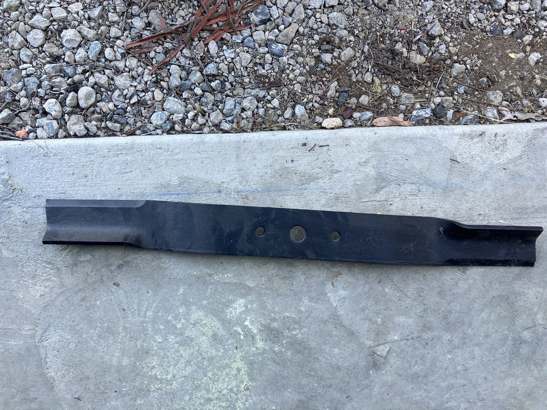

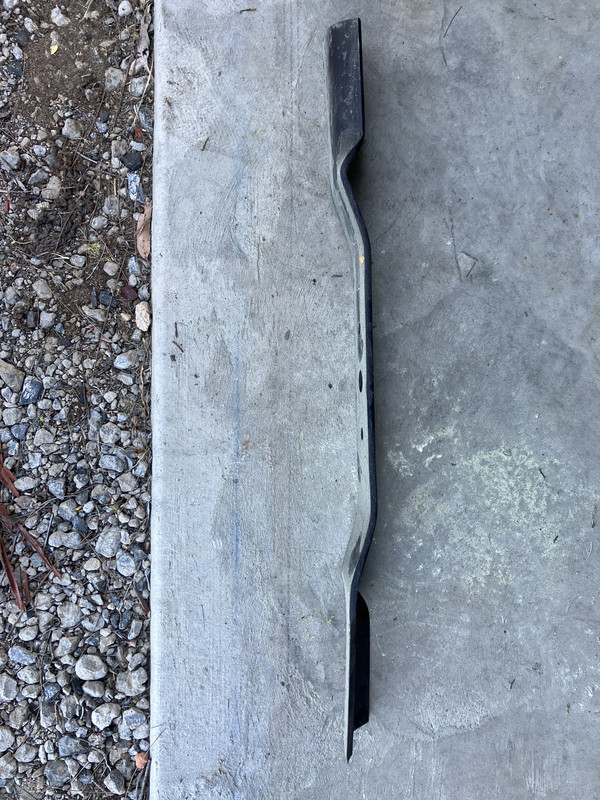

Can you put up a photo of the blades.
I assume they are just steel bar either mild steel or high tensile.
It would not be rocket science to bend some bar a mirror image of the existing blades saving all this gearbox drama. I think mild steel would work great but an old spring would work if you wanted high tensile.
Probably judicious heat on the existing blades could reverse the current offset and sharpen the back side.

Here's a couple of photos of the blades., I don't think you could replicate them in a reverse pattern due to the bends in them. If I did this it would still try and shed the nuts and blade.
I could grind a cutting edge on the trailing edge as this would improve the cut and perhaps lighten the load on the retaining nuts.
I did some more Googling last night and I've found some boxes that may work. Just a matter of getting my head around mounting the blades and checking both output shafts run the right way. It would be no good having all 3 belts running clockwise, whilst the middle blade spun CCW!
I have made a stopgap effort by welding lengths of steel on the blades each side of the spindles so the blade doesn't want to undo the nut, but I do still lose nuts and blades, but not every half an hour, more like every 12-15 hours.
I mow around 4 acres with this mower and it takes a couple of hours so the blades aren't falling off every time I get on it.

1 year 2 months ago - 1 year 2 months ago #254511
Replied by Lang on topic How to make a mower deck run in reverse
Flipping blades over makes no difference.
The flat bar is certainly worth a try. A judicious bend toward the end in the vice would bring it pretty close to original specs but lots of serious heavy slashers have horizontal blades with no twist.
