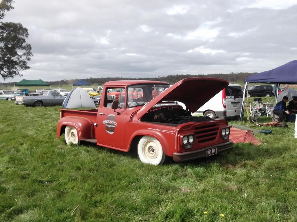

11 years 7 months ago #145240
by toggle
Replied by toggle on topic Re: Best chassis to use on a Dodge or similar.
Thanks BigCam that would be great, I drive a truck out of caboolture so i get around quite a bit. whats a C1100, the only reference I can find is an International? is that right how common are they?
11 years 7 months ago #145241
Replied by bigcam on topic Re: Best chassis to use on a Dodge or similar.
11 years 7 months ago #145242
by Sarge
Sarge
ACCO Owner, Atkinson dreamer.
Replied by Sarge on topic Re: Best chassis to use on a Dodge or similar.
Toggle, if they are the same price, take the blue one, less panels to rub back
/me
/me
Sarge
11 years 7 months ago #145243
by overnite
Replied by overnite on topic Re: Best chassis to use on a Dodge or similar.
Nice early blue one, six spoke spiders, high door handles.
11 years 7 months ago #145244
by spc383
Replied by spc383 on topic Re: Best chassis to use on a Dodge or similar.
I saw an at4 dodge at chopped last year. It had the original chassis with an xj6 jaguar front end with a valiant diff with the diff sitting on top of the springs. It sat really good and fitted really nice. If I were ever to build another little inter/ dodge ute it would be how I would go. The original chassis are straight and easy to mount stuff off as where a hq-z or f 100 are all twisted all over the place and to get it engineered it would be a rebodied hq or f 100 and more work than a front and rear end end swap. my 2 cents anyway good luck
