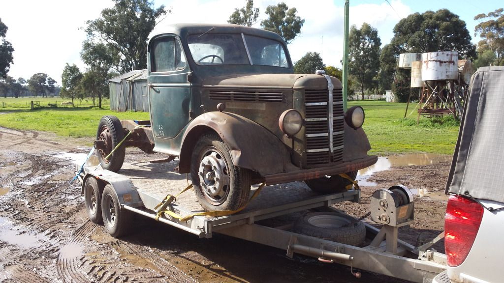

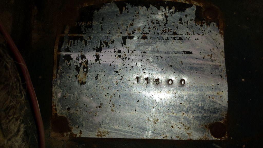

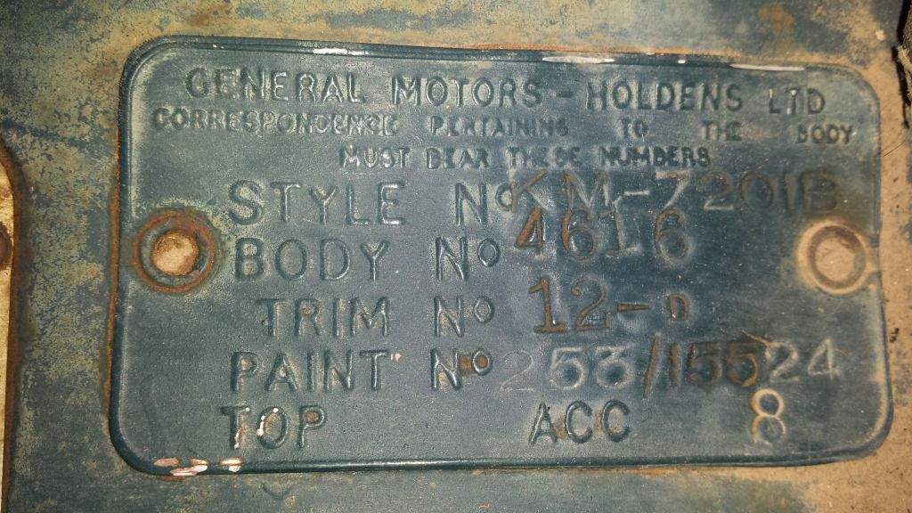

finalyy got the little M home, 734 km round trip, towed her with the great wall, plenty to do now!
How do i find what year it is?
M series Bedford home, the fun starts was created by scratcha
11 years 5 months ago #145591
Replied by mammoth on topic Re: M series Bedford home, the fun starts
Hard to tell with Bedfords but these people will have a good idea of build date. The serial number which follows the model (MSZ) is the chassis No.
www.acwbedford.com.au/
Part of the difficulty was that yours was built in England and then exported to Aus where it was fitted with the Holden cab. There were only a few minor changes between first and last, such as headlamp lens and bonnet badge.

Ive had a quick once over the old girl to see what work is required, so far it seem bugger all, just need to .....
do the bodywork & paint it
recon/ replace/ upgrade the brakes
retrim the interior
full rewire
give the steering and suspension a tidy up
replaced the tyres
fit a tray (sort of under control)
fit an exhaust
and reco the siezed engine, other than that , its a goer!
Having a look at the new regs for the CPS, I may replace the engine with a chev 6 and an overdrive box,the brake master cylinder is cactus, an upgrade to a later model from a different manufacturer may be the go, ill have to see what comes around....any thoughts?
