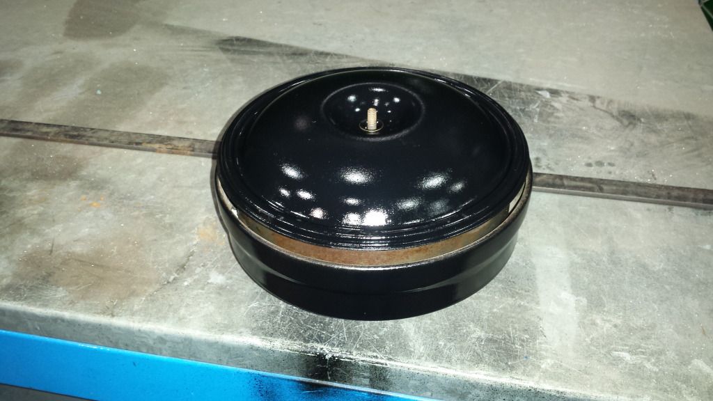

thanks for the reply yardy, No its neither of these, the fittings screwed into the side of the block near the oil pressure sender unit.
Maybe i should put this in the watzit page! :
11 years 5 months ago #145612
by Bugly
Replied by Bugly on topic Re: M series Bedford home, the fun starts
Hi Scratcha - it is probably a 'bypass oil filter' which picks up oil under pressure, filters it, and returns it to the sump. It is called a bypass filter as it is not inline with the pressurised oil feed, therefore not all the oil is being filtered during this process. The canister should come apart for cleaning the filter inside.

Those filters are described in old Ryco catalogs as being "throw away type", you can't service them.

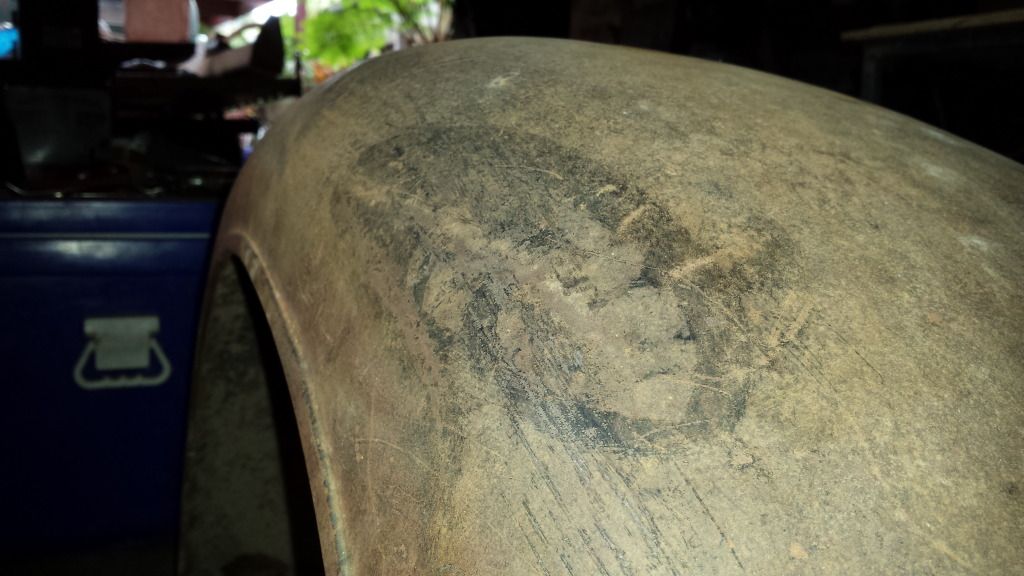

just a quick one, in the first photo of the last lot i posted, there is a stencil under the paint i removed from the floor/ gearbox panel, is it datable?
11 years 5 months ago - 11 years 5 months ago #145617
Replied by mammoth on topic Re: M series Bedford home, the fun starts
That looks like the steel works, etched on. Could be a Welsh steel rolling mills - R, T, & B at Ebbw Vale, Long since closed down. The numbers probably indicate thickness, alloy, heat treatment etc, but could be a date.

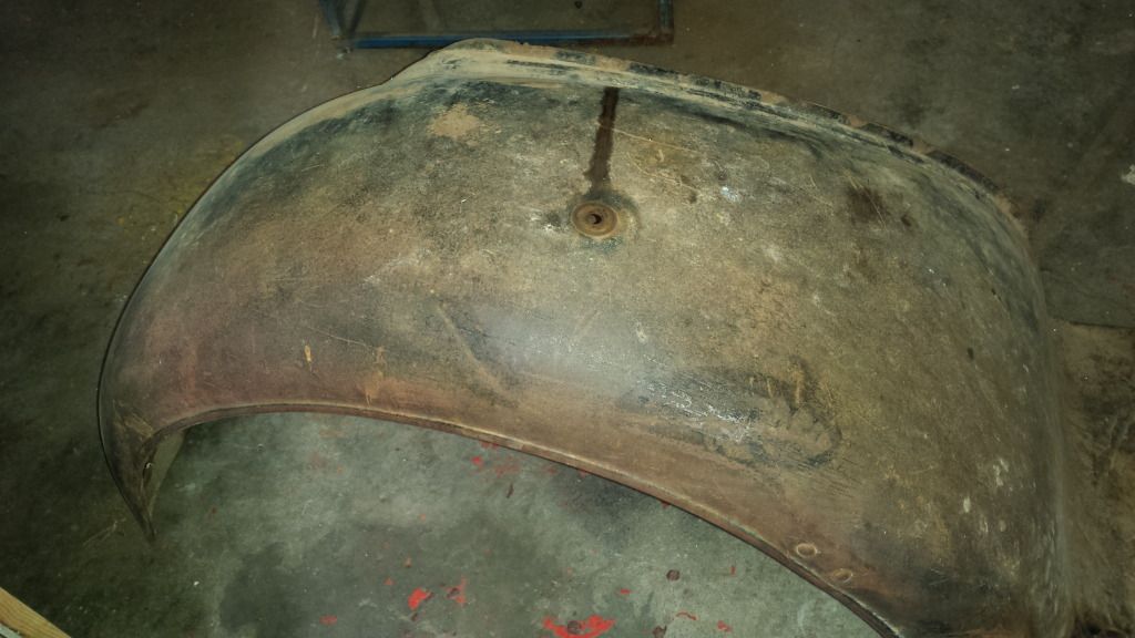

Done a few more things over the last week, its been bloody freezing and working 12 hour nightshifts are making it hard to find time.
Donk out
started to knock out the dings in the front guards, no rust, just fatigue cracks from a life well used
[IMG][URL=http://s386.photobucket.com/user/scratcha66/media/20140820_121834_zpsee957e4b.jpg.html][IMG]http://i386.photobucket.com/albums/oo302/scratcha66/20140820_121834_zpsee957e4b.jpg[/img]
