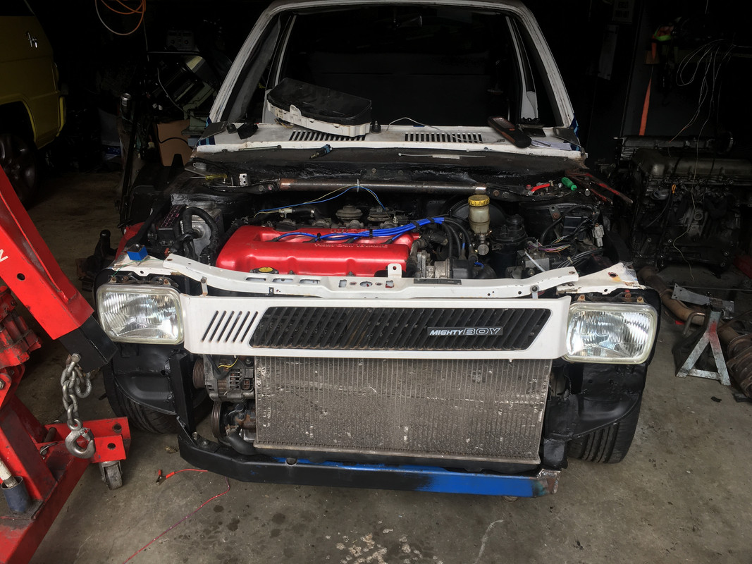

The engine fits with 15mm clearance to the body and crossmember. I’ve fitted all new rubber engine mounts (al standard Nissan on custom brackets) to keep engine movement to a minimum.

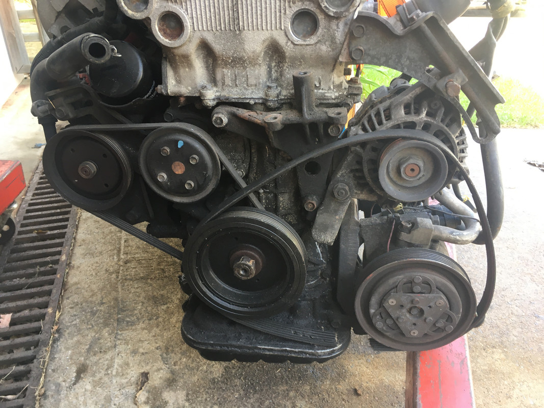

To make it all fit in we had to delete the air conditioning and move the power steering pump to the front of the engine. This entailed insert two additional idler pulleys to ensure adequate belt wrap where needed.
Before
After
The last real challenge is making the front driveshafts 135,mm narrower. I’ve decided to cut them at a 45degree angle, remove the appropriate amount from each axle (they will be different amounts) then machine up a sleeve to go over the joint. I’ll drill and plug weld the sleeve to the shafts. The sleeve won’t be transmitting much torque as it is designed to stop the two halves of each axle from moving apart. The 45degree cut will stop the axle halves rotating in relation to each other.
As it looks today.
Before
After

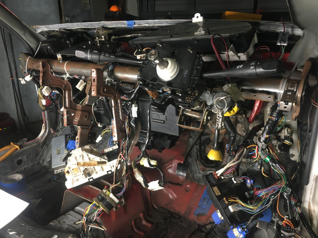

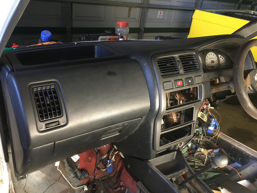

The big effort has been on the dashboard. The MightBoy is 136mm narrower in the cab than the Pulsar. This meant we needed to remove that 136mm from the width of the plastic dash from the Pulsar. Some judicious cutting and joining gave us the following.
I was under strict instructions the car had to have the white faced instruments, an uncommon fitting in Pulsars. Simple, buy a set and install them. Not! These white faced instruments use a module to run them against all other instruments fitted to Pulsars that are simple old fashioned gauges. These instruments required a matching dash loom to make them work. Now as we're melding Pulsar N14 and N15 wiring and switch gear with Matiz rear half wiring things get interesting.
After doing my head in again I think I have it all working.
The dash in the photos is a composite of two dashboards to get it how it is. The left hand end of demister vent is fouling the windscreen wiper motor so it will have a session with Mr Angle Grinder to sort that out.
Once the dash can go back in for the last time the windscreen can go back in and we can reassemble the body and give it a test drive.

Zuffen You are doing an amazing job. That dash looks like it grew there on the production line. The work you are doing is way beyond my imagining.
Well done.
