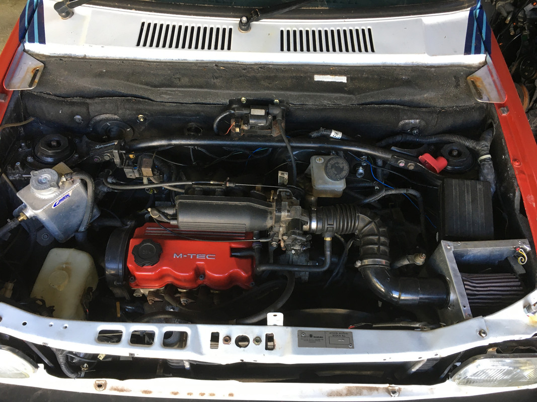

We re-installed all the mechanicals and fired it up and test drove it on axle stands in the garage. We have a Highway Patrol Officer living 100metres away so no quick lap of the block! We’ve already had words with this slime-bag. One issue we had was we couldn’t get it to give spark or fuel pressure. We searched for a day but couldn’t find a blown fuse, plug disconnected or any reason for the problem. Our OBDII scanner wouldn’t talk to the car and we finally surmised there was something wrong with the ECU. Close inspection revealed it wasn’t even plugged in! Once that was rectified the little car sprang into life.

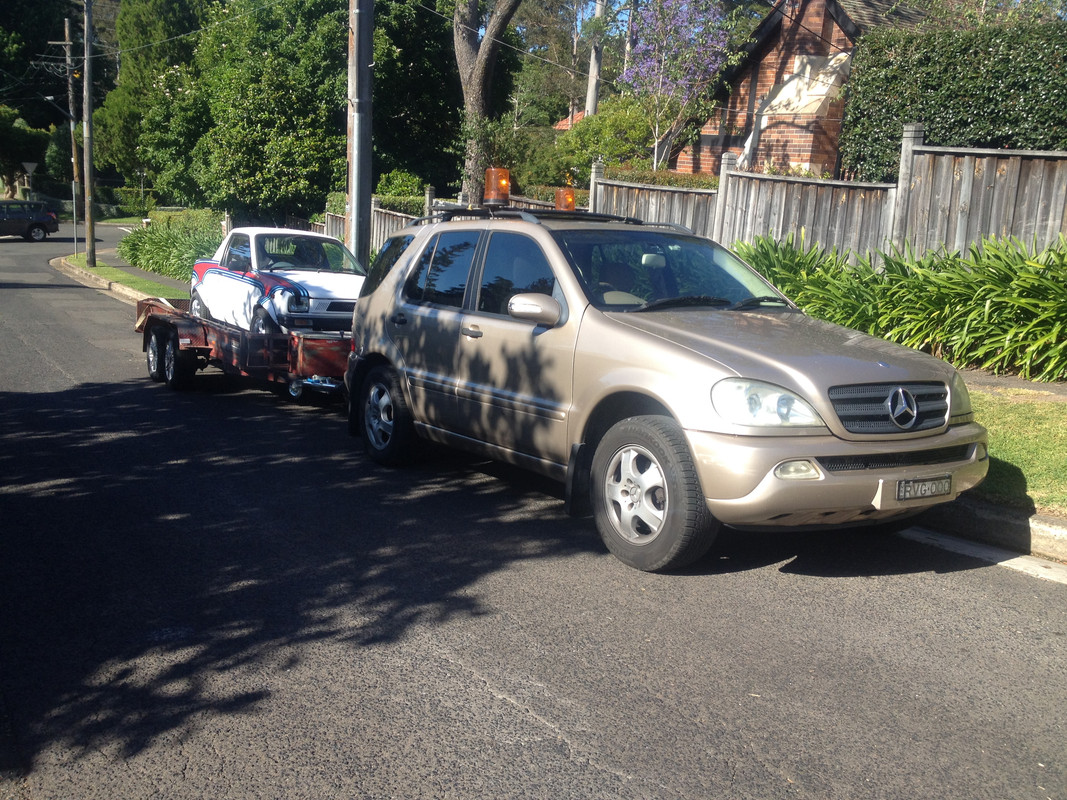

We loaded the car on the trailer and took it to a Relatives acreage and test drove it on their driveway.

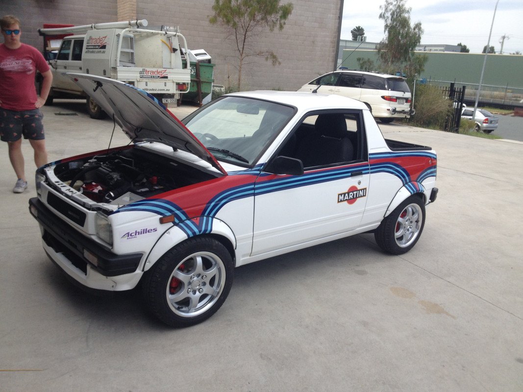

We had the car Engineered in Queanbyan than took it for its Blue Slip locally. The car failed as it was leaking plenty of oil. We took of the sump and re-sealed that and also the cam cover wasn’t quite tight enough. Once that was done it passed and received rego on the 18th January.
All loaded up ready to go for Engineering.
This is at he Engineer's place.
The car has 500KG of lead weights in the rear then they threw in the driver and passenger so it had over 700KG load on it. no wonder the rear suspension is a bit low.
Distinctive if nothing else.

Here is a shot of the almost finished interior. Somewhat different to what you expect to see in a MightyBoy! The dash rubs against the passenger's door so we may insert spacers behind the hinges to give it a bit of clearance.
So 11 months from go to whoa, but in that time I have been intestate 5 times and overseas twice so we figure we worked on it for around 8 months, probably 3 days a week. We guess around 1,000 man-hours went into it. whenever I say we it really means me. Lachlan would have put in 20 hours if he was lucky.
So what did this cost us? I figure we got out of it for less than $4,500.00 with Engineering and we have a fairly unique MightyBoy that drives like a 15 year old car not a 30 year old car.
During the build we installed a new cam belt, clutch spark plugs, leads, cap and rotor. So it should be good for quite awhile
At the end of the day we did everything bar install the windscreen (could have done that but it cost the same installed or uninstalled) and buff the paint when it was finished.

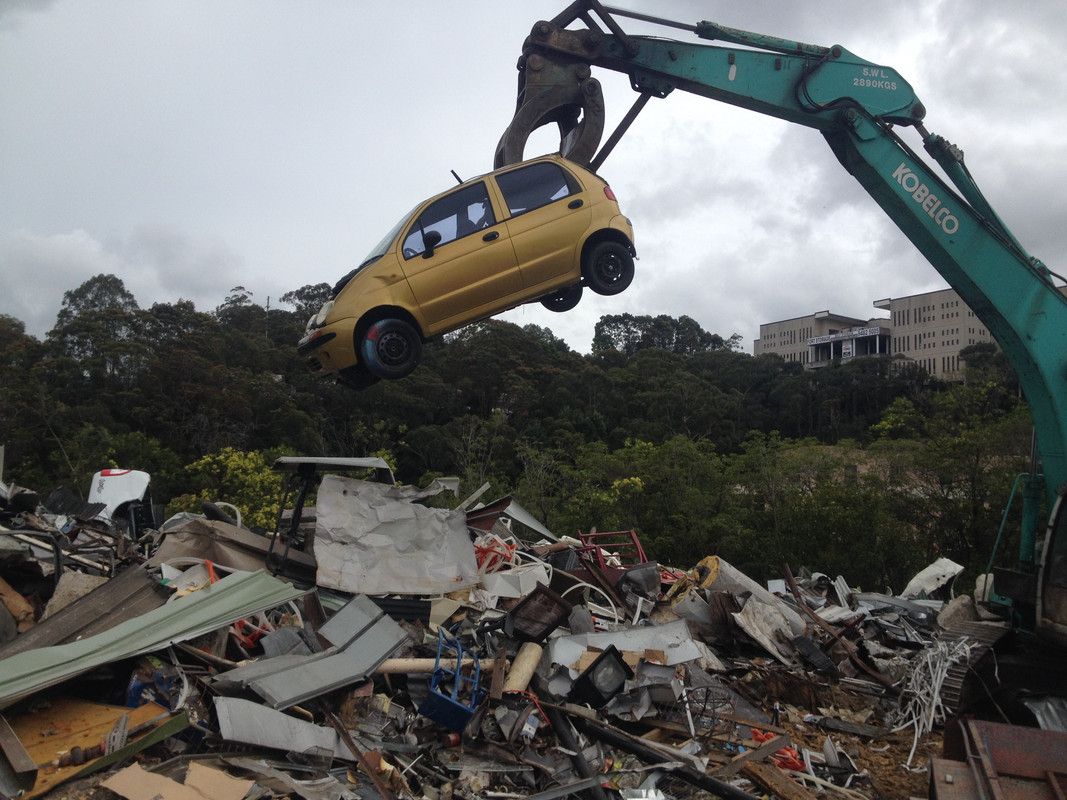

The clunky steering looked like a shot steering rack which is unique to the Daewoo and no longer available. What to do? Buy another Daewoo of course.
$200.00 later we had another car in the driveway. Much to my wife's disgust.
A few hours and we liberated an engine and transmission plus sundry other parts we may have needed in the future.
The remains were dropped off at the local scrap metal place and this is the last we saw of that Daewoo.
So the car is registered and driving around and being a hit wherever it goes. Only problem the engine is a bit smokey. No problem we have one of them spare.
Swapped it out in a day and it was mobile again. Only problem this engine was no better than the last and it started fouling spark plugs, which when driven by a mechanically incompetent 25 year old had me collecting it all over Sydney's north each time it died. Seriously if you gave Lachlan a screwdriver he would poke his eyes out!

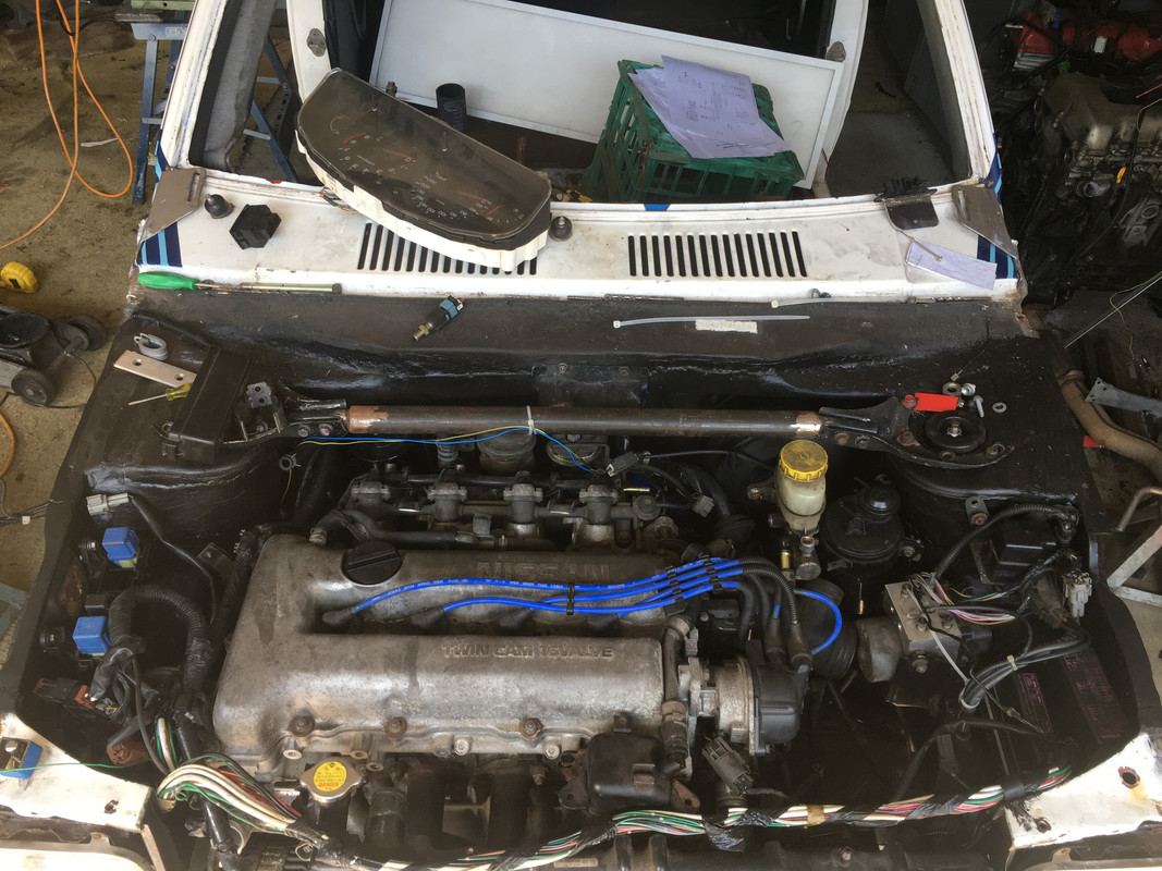

So the car will end up with a Nissan SR20DE normally aspirated 2litre engine. We just couldn't find the room for the turbo engine to go in.
Here's how it looked before pulling it apart (again).
And once it was stripped ready for surgery.
Let's have a test fit of the new engine. By the way the car came with 3 spare engines and a gearbox so hopefully one will be good.
If we cut a little here and weld a little there it may just work.
The firewall was removed for the second time and some other rather drastic surgery allowed the narrowed Nissan front subframe to fit and all the Nissan suspension components to bolt on. This meant we had the brakes the car would need and the Nissan steering, which solved the clunky steering problem.
