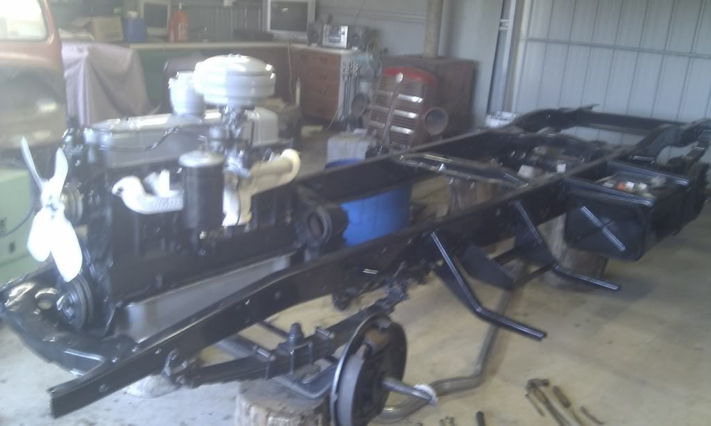

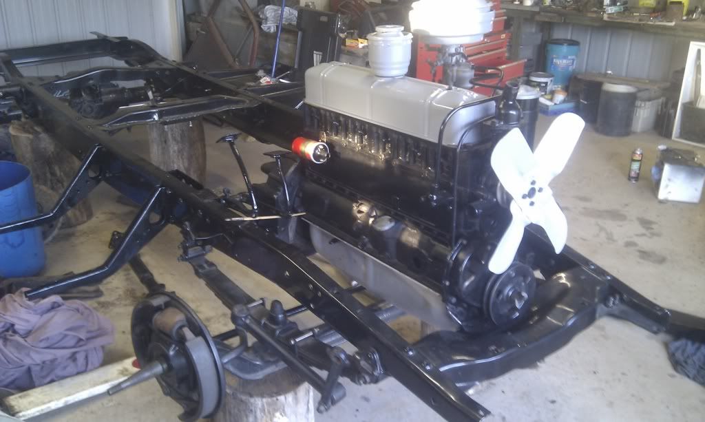

A few pics of my beddy resto
14 years 1 month ago #73129
by Davefarma
A few pics of my beddy resto was created by Davefarma
14 years 1 month ago #73130
Replied by on topic Re: A few pics of my beddy resto
g'day davefarma...imho that is looking like a world class restoration.....good luck with it and cheers
14 years 1 month ago #73131
davefarma
Wow looking good, and i've gotta get myself a set of those stands.
Trevor
Trevor
14 years 1 month ago #73132
by Davefarma
Replied by Davefarma on topic Re: A few pics of my beddy resto
Thanks detective, and geez slo speed from what i have seen your work is first rate. hopefully this weekend i can start the old girl.

14 years 1 month ago #73135
by Davefarma
Thanks Don but last night i sat down and had a think about which way the dizzy spun, i put the drill in reverse and like you said in a few turns it was pumping oil, after about a min i had oil running through the filter case and all along the top rockers.
Im cleaning up and painting the fuel lines today, just need a seal the goes under the glas in the fuel pump, i tried to make one out of some cork gasket but it wasnt thick enough. I will also make up a frame to hold the radiator in place so i can run the motor while i work on the front grill.
I forgot to mention i had troubles getting a timing cover seal, i needed a seal with an od of 2" and an id of 6000 over 1.5". the closes seal i could get was a 2" od and a 1.5" id so i ended up getting a guy down the road to take 6000 off the boss, the seal fetted perfectly.
Max when i started restoring my truck i bought a second truck aswell. the guy had started to do it up, he had sandblasted the chassie and primed it and then top coated it and thats as far as he got. it sat for over 8 years and then he sold it to me. so i started with the chassie partly done, since then i have done the running gear, side steps, tank and tank arms, stearing and the motor. I just need to find one more rim and i can get it to rolling stage. Next job the cab and pannels and then the tray.
