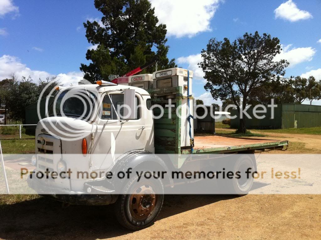

Love to see a pikie of said Karrier.

13 years 1 month ago #98641
by Hank the Truck
Replied by Hank the Truck on topic Re: Seized brake drum on Hank.
