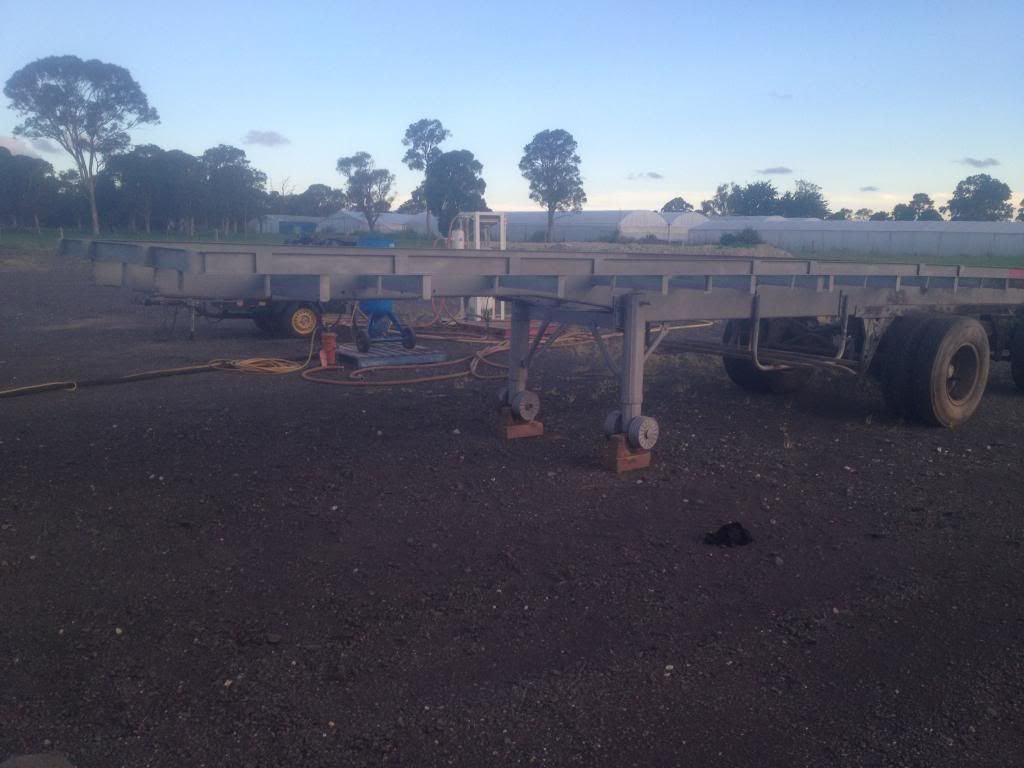

Treid to do a bit of sandblasting today.Only got to do the front half due to dramas.You learn something new everyday, my lesson is not to sandblast flattop trailers, what a pain in a$$!!! Here's is today's effort.
Hoping to pull suspension out and tyre carrier off for tomorrows effort.

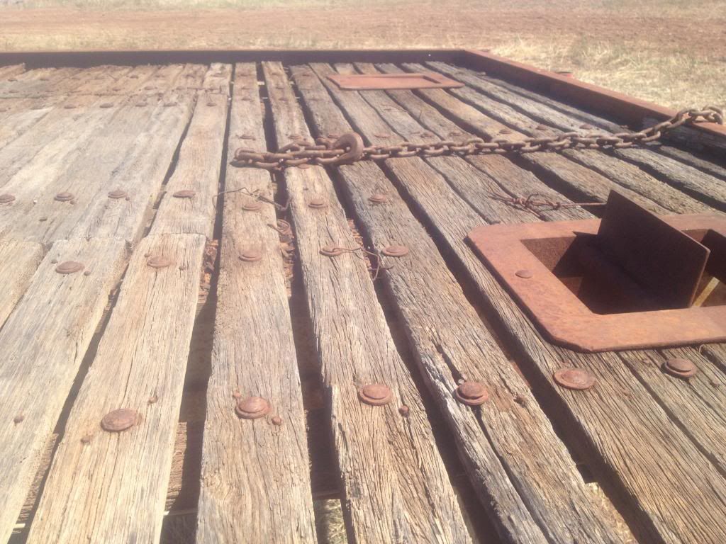

This is what the old floor looked like.Was told the gaps in the timber were for when they carted sheep and it had a couple of grain shoots [12 of em] and as old mate said "we only useta put 40 ton on her"
