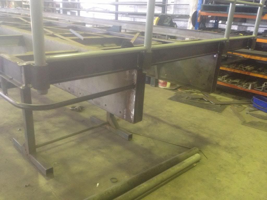

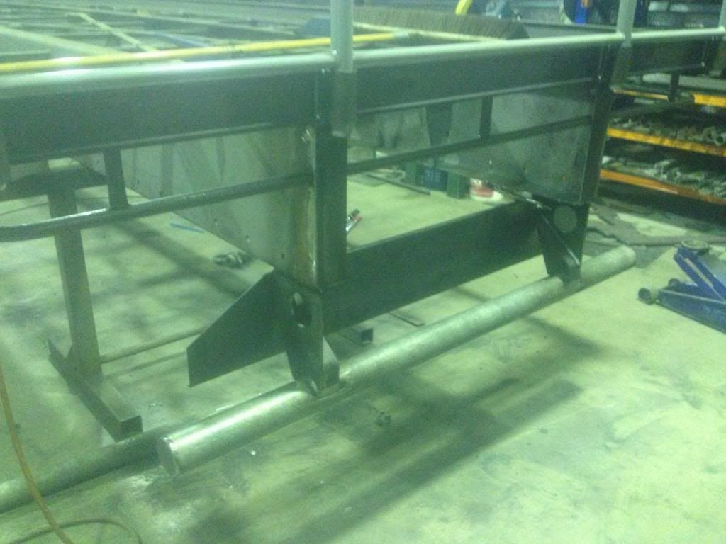

Hi all a little more progress this week.
put a new back chanel in and gate pockets next is the rear bar.

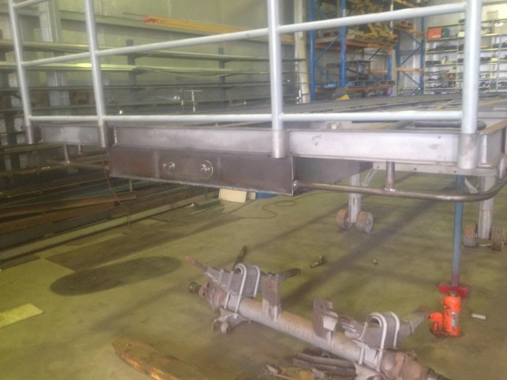

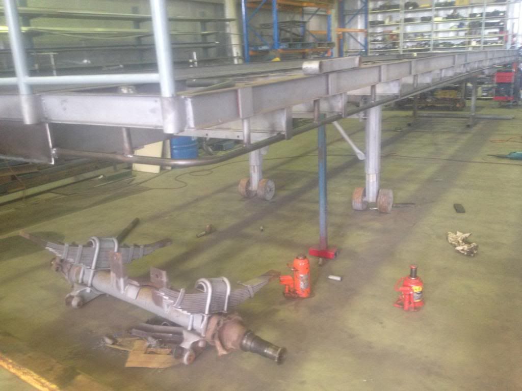

Hi all thanks for the comments.Still debating on what to cover the timber with,was told to use linseed oil.Here is a few photos from yesterday thanks.
if the shoe fits wear it!!
