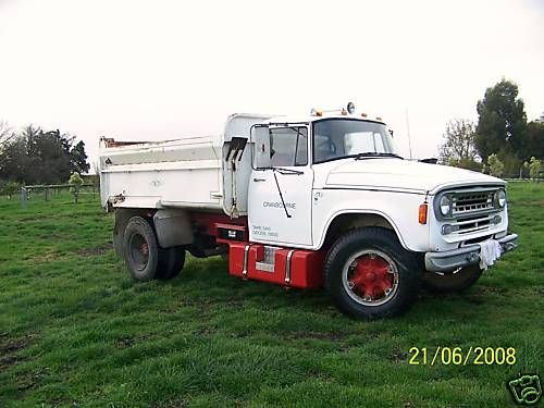

Thes two were on ebay recently. The tipper is an 1800 and the tow truck is an 1840. I didn't get a chance to have a look at them in person, but they sounded pretty similar as described by the sellers (160 Cummins, 5x2 cogs, air over hydraulic brakes).
I really wanted to have a look at the tow truck, but it was up north of Sydney and I couldn't get the time off work .

Awesome tow truck!
