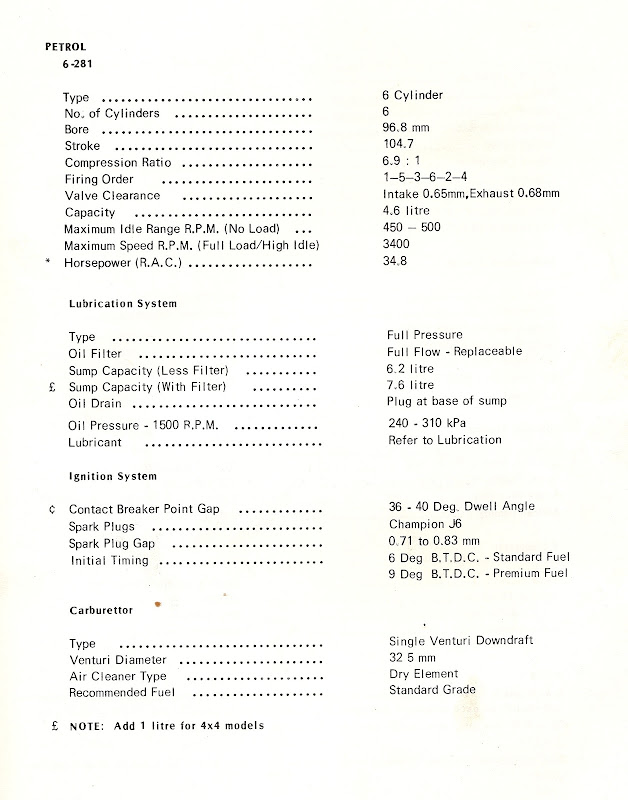

Anyone have specs on inter 1210?
mainly after GVM TARE, also compression in psi for 281,
tks,
tks,

G'day treepirate. You sure its a 1210?. Not a model I've got listed in any of my books. However, here is some info that may help:
If you want the actual engine compression rather than just the compression ratio, 90-105 psi would be within the expected range They are fairly low compression engines.

Thanks lads, could not find anything with google,
compression test put it 125psi (cold) which I thought was ok, the milage if correct was showing 86,000 miles, get the feeling it is close to that by condition of the rest of the vehicle,
Yes I am sure it is D1210,
looks like it was registered with 7.00 x 16, hopefully will succeed getting rated with the 7.50 x 16
But thank you for the brochure's will figure out how to put up pic when get ute home,
cheers
