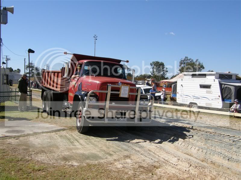

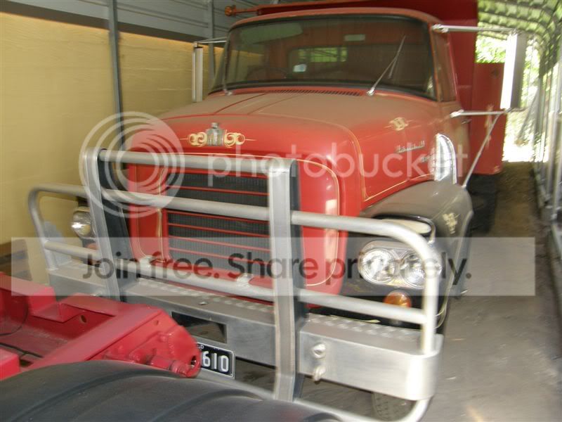

Replied by bigcam on topic Re: Many other Inter BCFs in Oz?

Yes Bigcam, it does look like the same cab, which means I may be in luck. Mine is a 1962 model I think with Perkins 6.354 as original I think and was a water tanker around Penrith in the late 1960s. The blinkers on top of the gaurds arre the main giveaway it's a BCF, and was about 17 Tonne GVM, even with narrow front hydraulic brakes.
When there was a thread on an R190 Restoration, with the spider drivetrain & twin stick shifts, the mechanics sounded the same. In the USA would have been fitted an Black Diamond petrol 6 & I'm told could also squeeze the 345V8 in itas an option. USA designed cab with the brake pedal operated via linkage to activate a passenger side master cylinder on firewall.
I will try get a reasonably rust free Loadstar cab now.

SoftHeartedScotsn - Good find, shame about the rusty cab. I'm 99% sure the BCF cab and the Loadstar cab are identical.
We had a good discussion about BCF's previously. I believe you have a particularly rare truck.
What is more interesting is those Canadian/U.S.-style indicators, that don't appear to feature on any pics of any other Aussie other BCF's, that I've seen.

Steve your cab looks the same as a loadstar,but all the other photos/brochure pics of bcf,s dont have the bulbous roof of the F1800 loadstars,i wonder if your one has been changed earlier on by someone,just an observation

Good point JohnP,
Not sure.
Body plate is inside passenger door jam saying BCF180, but that could have been transferred over if re-cabbed. Certianly, that's what I would have to do as a good cab would be easier to fix, than rebuilding this one falling apart. has a yankee brake set up thouhg, with vacuum hydraulic brakes with master cylinder on passenger side of firewall.
Anyone have a definate way to tell??
