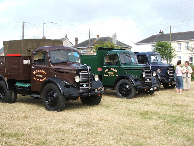

As I have seen how much you all love Bedfords I thought that I would post a couple of pics of local (to me) Bedfords taken at on of our road runs in 2006. Two of the O types are from 1951 and the other is 1950.
The 30cwt WS is from 1932.
As Australians seeem to like to take a quite serviceable English lorry and improve it, as you did with Atkinsons, I would like to know if the same was done with Bedfords. I know we had an option of a 6v71 or 8v71 in the TM but did you improve the TKs etc?
Rod
ps The Mammoth Major trying to hide behind the WS is from 1939.
Rod
