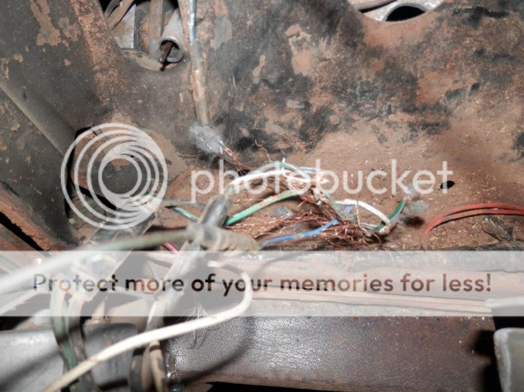

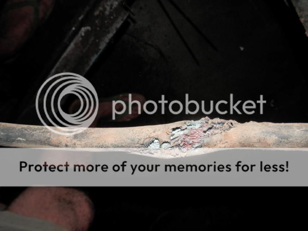

Due to the rigorous maintenance schedule that all farmers give their gear I only had to a few minor things to get the old girl up to scratch. New kingpins, front brakes, treadle valve, relay valve, tailshaft, replaced almost every hose and all the belts, changed the oil filters, pumped 20l of oil into the diffs, cleaned all the breathers out, new windscreen and rubber, rebuilt the Horton fan clutch and probably twice as much I've forgotten about. I put an isolator on the battery's which was a bit fortuitous as one of the positive cables had rubbed through on the tipper hydraulic valve and I wouldn't have spotted it otherwise.
I could smell a bit of burnt wiring in the cab and found a little mouse resort behind the speedo and tacho, how much nutrition is in plastic insulation?

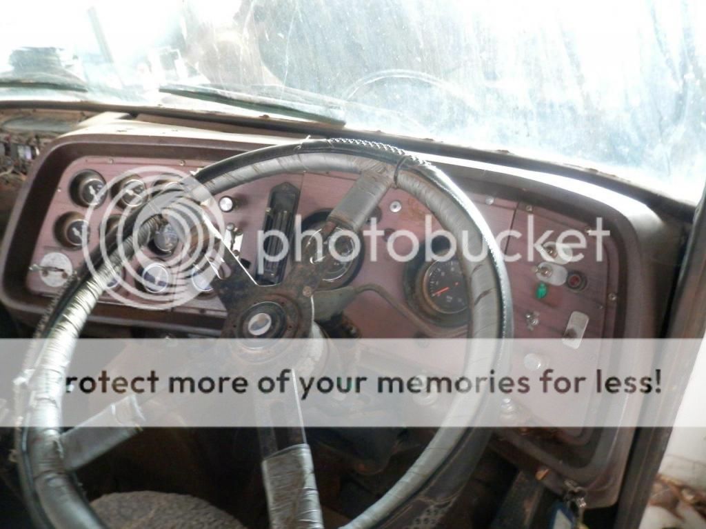

And lastly, an interior shot for Whale, showing the custom steering wheel.
