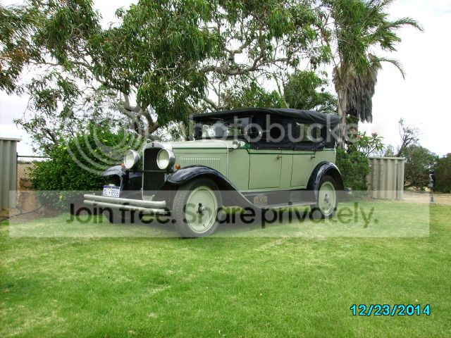

Hello Jim,
The car was done by lapping the metal and close zaps with the MIG, body filler was used in the step, a butt join would probably be the proper way but that is how he did it.
On flatter panels I have folded a zigzag so that the outer face is flat and filled the gap with filler, the bottom sections of these doors were done this way.
The thicker the metal the easier it is to avoid burning holes.
There are more professional jobs than my efforts in Restoration Chat.
David.

Thanks for the nice pics and welding advise
like any back yarder the first steps are the hardest,
i will pick up some sheet today i hope, the first supplier i asked did not stock it.
i would be guessing but the beautiful car you have restored, '27-28 Buick?

Jim,
It's a 1929 Nash Standard Six.
David
David

That sure is real nice!
A credit to you,
