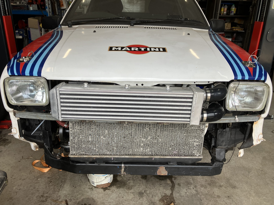

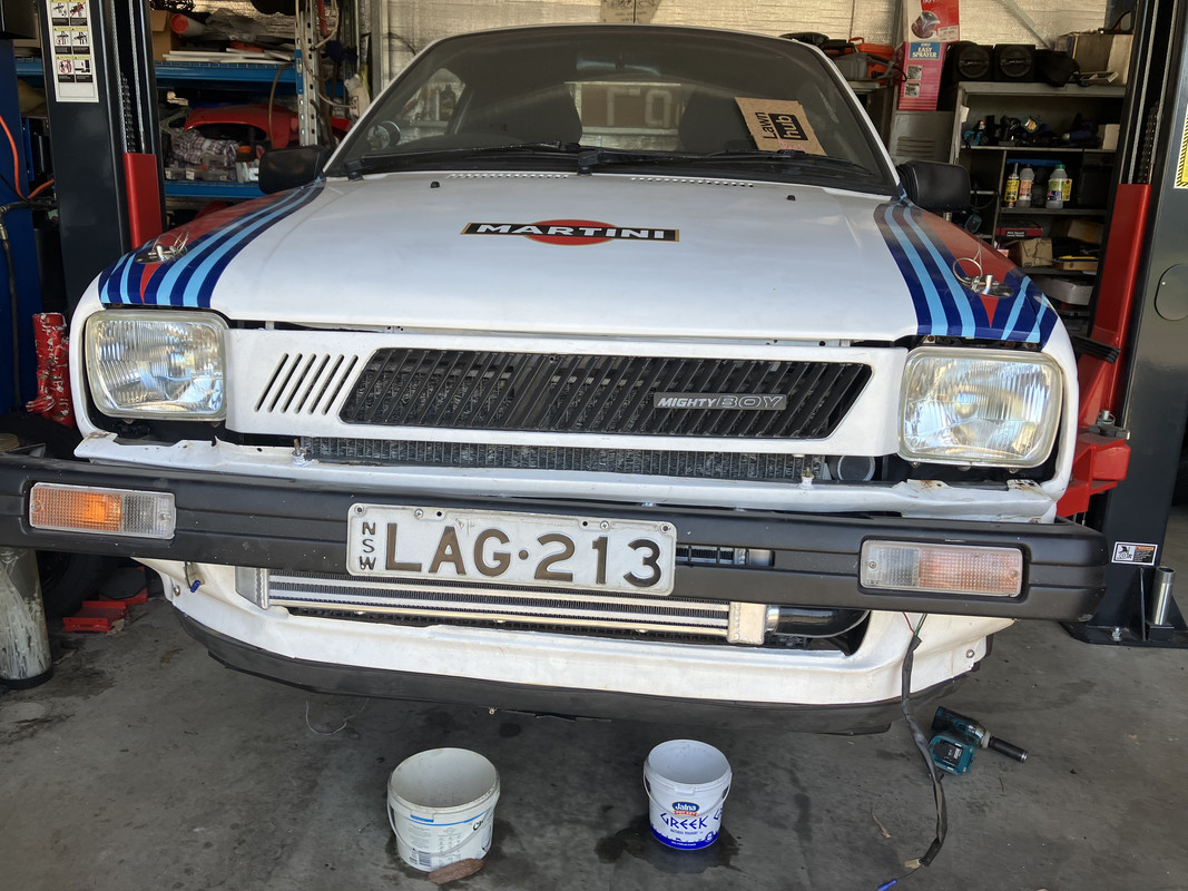

The little car now runs but hasn't been driven.
After removing and replacing the engine it has 3 oil leaks, all fixable and a coolant leak that is a hose that for some reason is way beyond reach and you would need arms like knitting needles to get in there. At least I'm aware of the problem and I sure I can work a way to fix it.
The engine runs well and has a nice turbo flutter when you back off, so should keep the boy happy.
I had a Hot Rod mate over on the weekend and he suggested looking for a new spot for the intercooler. Like I have space to burn on this project!
This is how it looked on Sunday.
And following a bit of rearranging.
The changes will mean it looks way better and will entail a bit of alloy welding and a few new hose joiners but it's all part of the fun.
One day it will run and drive.
