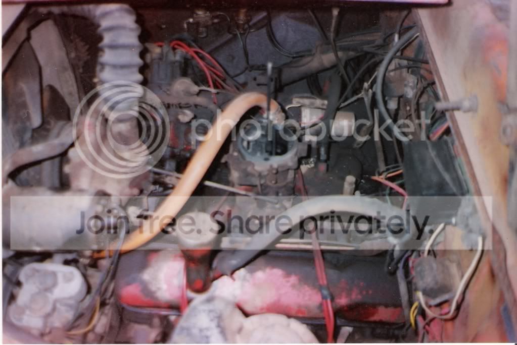

I have a photo of the 361 in our 1071 Power Giant.
You can see it is a tight fit especially with the Westinghouse air pump and power steering pump added.
I think this was original factory fit and firewall looks similar to yours also.
How does one insert or attach a photo to replies?

15 years 10 months ago #22350
by MILU Park
Replied by MILU Park on topic Re: 1959 Dodge 3-59D
[img][IMG]http://i1040.photobucket.com/albums/b407/Milupark/power%20giant%201071/scan.jpg[/img]/img]
[img][IMG]http://i1040.photobucket.com/albums/b407/Milupark/power%20giant%201071/scan0002.jpg[/img]/img]

Thanks for showing the pics.
I am still not sure what I did wrong but will have another go.
The old girl still looks good and she is still registered too.
