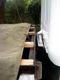

You will need to put something inbetween the cross members if they are 630 centres. About 450 is about as far apart as you can go with a 3mm floof if you don't want the "oil can" effect. If you are putting that machine on it, with a 3 mm fllor, it will dip in between the crossmembers. 5mm checkerplate is what they use for a heavy duty floor, and is not uncommon, 3mm is light duty, for putting pallets on.
The U bolts holding the tray to the chassis havn't got packers inbetween the chassis rail to stop them distorting the bottom flange either. You probobly want to cut a bit of 50 x 50 RHS and stick it in there.

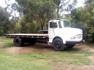

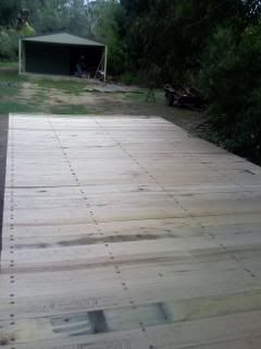

Good one mate, it would have taken more modifying than it was worth to put a steel floor in, and you've also managed to keep it looking like it was built.
Don't showing off those McGrath mudflaps too much, they are a bit of a rarity nowadays as well.

On the orginal 1418 factor prime mover without the chassie been lengthen what length of tray could you fit?
Could I carry a machine which is 4m long and weight of 5.8t?
14 years 1 week ago #41523
by Chocs
Weight:
It depends on what the tare weight of the vehicle is.
On a short wheelbase you may not be able to throw the weight correctly to the drive axle
Tray length:
Overhang must not exceed 60% of the wheel base or 3.7 metres, ( overhang measurement taken from centre of drive axle to the rearmost point of the tray)
(source VICROADS)
chocs
Replied by Chocs on topic Re: Fitting a steel floor
Weight:
Tray length:
(source VICROADS)
